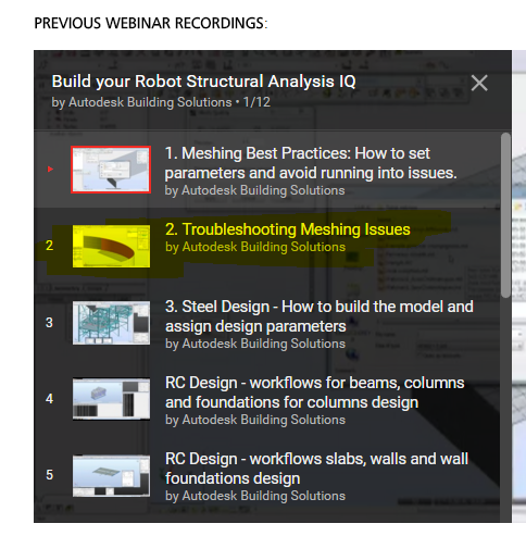

Make sure you did't mark the bar intersections next time.
I would suggest using the detailed correction instead as well as watching the 2nd RSA webinar which shows the set of best practises for this task.
http://forums.autodesk.com/t5/robot-structural-analysis/robot-structural-analysis-webinars/td-p/5523...
