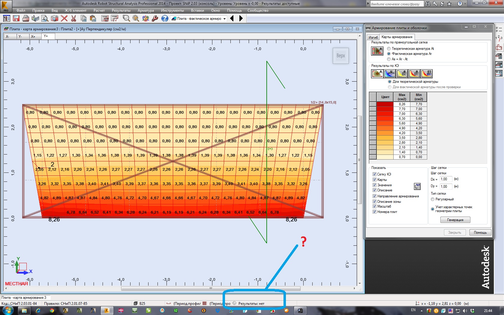

Nairi85
I am having difficulty in the program.
I expect a simple console monolithic slab. Please see the model, and explained to me why the Robot gives so different results ??

Artur, the same console plate with identical loads and properties calculated by the rules SNiP 2.03.01-84 and EN 1992-1-1-2004.
Results differ by almost 4-fold.
Please see the model:  http://joxi.ru/GrqMj0dsxXGYrz
http://joxi.ru/MAj0E87Fo0k7me
http://joxi.ru/82QVBGpSpL95Ad

Hi Nairi,
I'm sorry but I'm not able to make the comparison of results for two different codes and tell that one is wrong and the other is right. I remember making such test for shear reinforcement in a beam according to old Polish code (which was based on SNIP in this area) and then newly introduced EC2 with two sets of concrete struts inclinations. The results (areas of shear reinforcement) for each scenario were entirely different (by far less reinforcement for PN/SNIP) but perfectly right according to the selected code.
On the other hand if you indicate what for particular check is done correctly and why you think it is wrong then we will try to investigate this area. Thank you for your understanding.

But for me it was a problem that occurs seriously, in terms of confidence! There can not be such a difference in the results! If the difference was small, I would have considered it as the difference between the codes. But as I said the difference is very large, and as a builder I know from practice that is not correct. It can not be that one code calculation gave reinforcement bar diameter F14 and F25 on the other code.
Artur I do not ask to compare the results, please see both the file and my screenshots, and please specify the reason for such different results. It is very important to me, I'm always inclined to trust RSA, but such moments are always there are big doubts.

In older versions it was assumed that stress value is reduced to the level for which the linear behavior of creep can be assumed. In v.2015 the available range of reinforcement calculations settings was expanded to allow for nonlinear creep which is as you can see a choice rather than "replacement". This is a part of the continuous process of adding new and improving existing features of the program.

I mean, as in the 2014th version of RSA to obtain a correct reinforcement for this slab for EN 1992-1-1-2004.

As in Robot 2014 this option is not available the results you obtain are the same as when you switch off use of this option in Robot 2015. To be able to use this option you need to use version 2015 instead of 2014.
