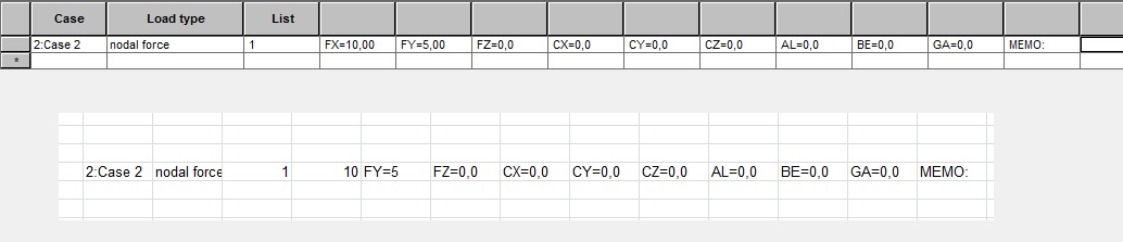

Using Excell without VBA
- not possible to create simple case by ordinary copying by clipboard contents of excel file to robot Loads table
- possible to add \ modify loads to existing load cases by copying by clipboard (of course cells data \ order should be the same as in robot Loads table \ Edition tab ; keep in mind that some excell cells may need to have cells format Numerical instead of General)
- possible to create combinations this way but without controlling its number ; modification possible

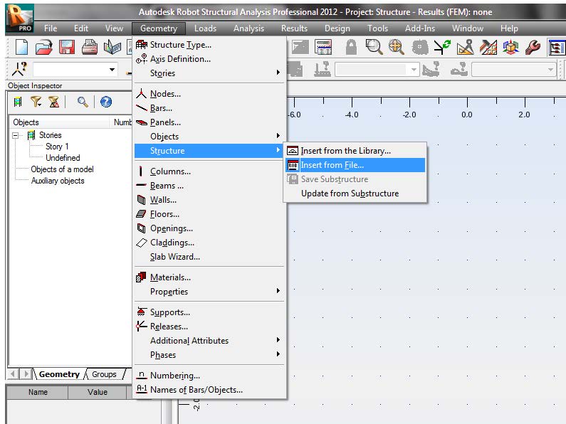

STR File:
If you want to play with it (NOTE: not all kind of loads are supported by this format for eg panel \ countour loads) :
- syntax described here : "c:\Program Files (x86)\Common Files\Autodesk Shared\Structural\Help\2012\R97mod01.doc"  ;
some str file examples can be found here: c:\ProgramData\Autodesk\Examples\Example.001

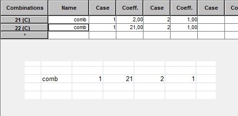

Then I change some factor definitions etc, then hit the button to update my Robot file.  The Combinations went completely crazy.  Some combinations that only had 3 cases ended up with 5 or 6.
You can not copy easyly combinations from Robot. Take a look at cells order in robot Combinations table:
casenumber ; coeff; casenumber ; coeff....
In Excel : cases are "columns" so in cells of combination rows you need only coeffs in proper columns.
