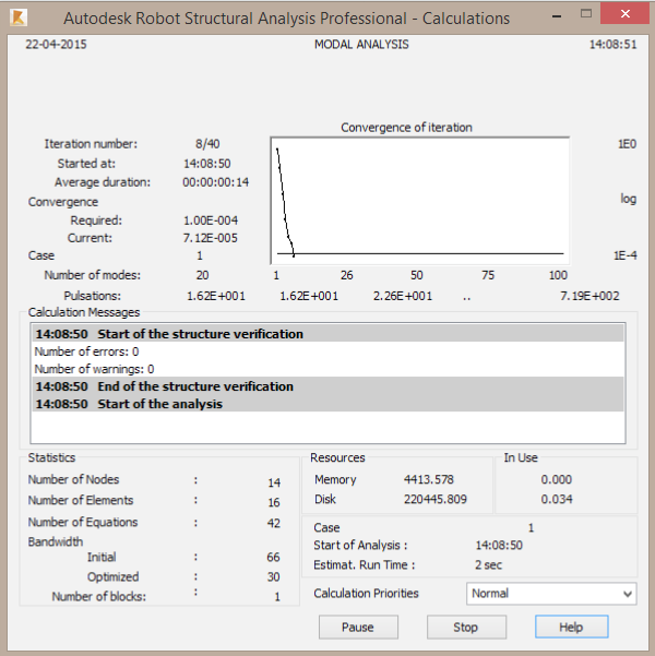

2) Calculations
Below you can see calculation data for each model where you can notice difference in iteration number, nodes, elements etc.
I have noticed that In Model 3 the slab is not divided in finite elements therefore it has less nodes and less elements which ofcourse makes the model less accurate than the other two models.
My next question is: Model 1 and 2 have 98 elements which i am not sure about since the structure is made out of 8 columns, 8 beams and 2 slabs with each slab divided at 25 Finite elements therefore,
total = 8 + 8 + 50 = 66, why do i get 98 elements?

Message 17 of 24
t.sautierr
0)Triangle :  it just means that you slab is considered acting as a diaphragm : no relative deformation in the points of th slab, it has a movement of rigid object.
1) warnings : did you put some releases in your slab ? it can come from this because otherwise your mesh looks good.
2) display the nodes AND the calculation nodes : I think RSA has added callucation nodes in your beams and columns (divided for the cals has you have set coherent matrix) : 98 -50 = 48 / 16 = 3 you shall see two calculation nodes in each beam and columns, then divided in three parts for calcs.
