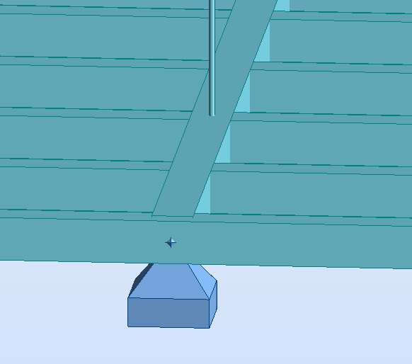

Hey guys.
I would like to have the continuous beam at the bottom, and the other bars located across on this. How do I do this?
Thank you.

Rafacascudo
1st option - Rigid links
2nd option - Bar offsets
Both on Geometry/additional atributes
