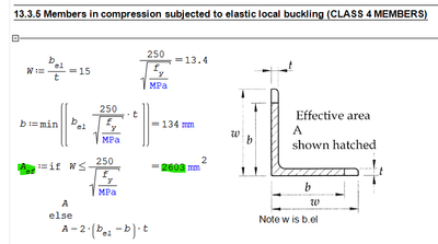

The hand calculated value for class 4 section effective area is greater than Robot Effective area for AEP150x150x10:
Please advise how this is calculated.

I've checked your calculations for fy=350 MPa.  They seem reasonable.
I will ask development team for checking how it is calculated.

Sorry for the off-topic, but is it possible to keep the class description in line with the CSA S16:19? For example. like in the picture above, it should be Class 4 instead of Slender.

There is a difference in using limited slenderness for angles legs "bel/t".
According CAN/CSA S16:19 it should be used limit bel/t = 250/sqrt(Fy) while RSA uses more conservative values bel/t = 200/sqrt(Fy).
It has been registered for correction.
