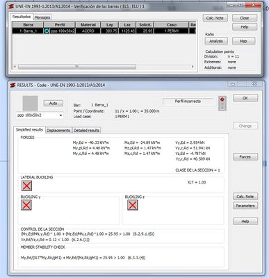

i'm trying creating new profiles z-shaped.
I'm working in section definition enivroment and importing a dxf profile to create it.
Everything works well but when attempting to calculate it there is a problem with the lateral buckling, it's not calculated. It seems to be a problem of the web and flange thicknes and wide definition, as they appear as 0 mm values, so the XLT is 1 and lateral buckling is not calculated.
I don't understand why, i have worked in the past with other z-shape profiles from standards and i hadn't this problem.
Anyone could help me?
Many thanks in advance

Actually I'm not sure what you mean. I've imported a .dxf file with the contour section
But when attempting to see this section in the database the problem begins:
Thicnesses and radia seem not to have been define properly as thay appear as 0 value.
And finally when attempting to check buckling or lateral buckling these check are not carried out:
I don't know exactly why, but it seems there is a lack of section properties:
I think i'm working with what you mean as 3D section, as I draw the real perimeter of the section not just the middle line.
Please, further help?
Thanks in advance
Jorge

When you fill the table, you have to click on the following line in order to save the data
