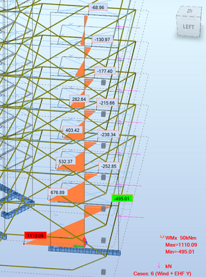

I am having a problem trying to interpret core wall results.
My Mx and My diagrams are sawtoothed (positive moment at bottom of panel and negative at top) in nature as opposed to gradually increasing like the Fz diagram. So the moment should be 0kNm at the top of the wall and a maximum at the base.

The bending moment at the base of the wall in accordance with the above shear force profile should be 5235.4kNm. I am getting the following bending moment profile, which is intuitively not correct:
I am really confused. The bending moment should vary roughly linearly from 5235kNm at the base to 0kNm at the top.
I have modelled the slabs as rigid diaphagms - could this be a reason?
Any help or explanation welcome.

Hi @keith483GL
In my opinion slab defined as rigid diaphragm (full stiffening ) causes this effect
In your model results diagrams for core walls looks as follows.
When flexible diaphragm calculation model (stiffening in XY) is used for slabs diagrams looks as expected.
Similar effect can be observed for simple 2D frame for middle column simulating core wall, when beams are defined as rigid  members (right diagram) and flexible members (left diagram)

keith483GL
Thanks @Krzysztof_Wasik this looks a lot more sensible. I will use slab-flexible diaphragm going forward.
The top of the core bending moment diagrams in your example and my model still look a bit funny. Why is this happening? It would be good to understand this.

Hi @keith483GL
You will obtain smooth diagram when beams will be connected to colum with pined connections.

Hi @keith483GL
You can define linear releases between slabs and core walls. (Geometry >Additional attributes>Linear releases) but since core wall is connected with slabs in more than one node (along lines), in mode cases you will not avoid "funny" diagrams for core walls moments when slab stiffness is regarded while calculations.
