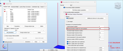

I've tried to model a 15mm thk steel plate with 203x203UC46 steel column section(pls. see attached file).
The steel column is offset from the center. But I encounter some convergence problems.
Any particular reason why it is happening?
Any help will be greatly appreciated.

change mesh size to 5cm and nonlnear parameters to the picture below
Rafael Medeiros
Message 3 of 16
saclovitzky
Thanks@Rafacascudo for this,the convergence problem is gone.

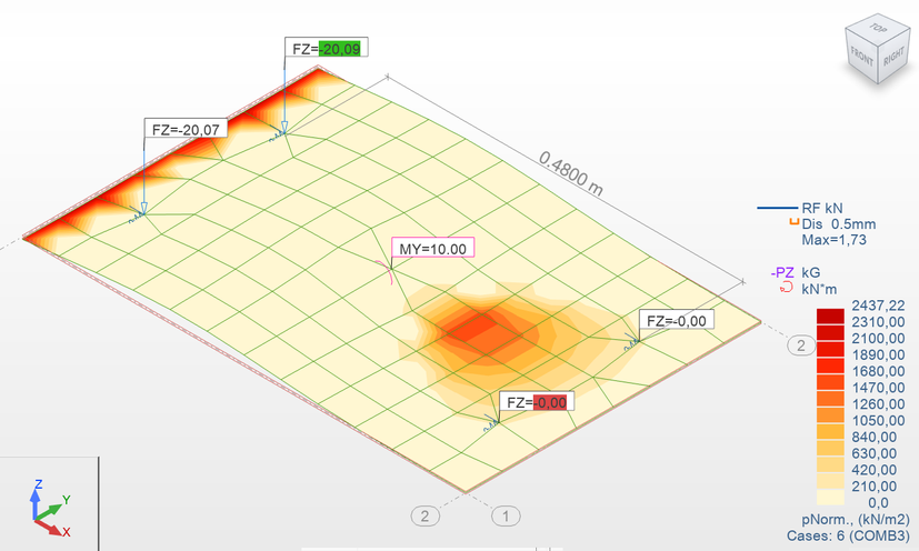

@Simau Thanks for this.what really bothers me is the result,the anchors are symmetrical with the moment at the center(between the achors of the opposite sides).
when a moment acting at the center of the supports ,it produced equal compression/tension reactions(couple);ie, M =15 kN.m, c/c distance =0.48m,then, 15/.48 =31.25 kN(31.25/2 = 15.63 kN/bolt), but since the support nullifies the compression(-z),only the uplift will show(in this case,the linear analysis produced 65 kN/per bolt! ).
In my opinion the result is not acceptable.did I miss something here?

Your verification is not correct (You forgot reactions at finite element nodes).
So that you can see all the reactions (at the anchors and in the finite elements), I've used  surfacic support instead of soil parameters directly to the plate.
Redo the check with all reactions (at anchors and other nodes)
Model attached

Let me add a few more thoughts to your discussion. No, I don’t think the reactions can be symmetrical.
Another key point is that the load application isn’t a true point load, it’s the 203x203UC46 section that transmits rotation to the plate. As such, even the forces in the rods should be evaluated by including at least a small portion of the column, to reflect both its stiffness and its ability to distribute loads.
It’s also worth noting that you're assuming the concrete provides uniform pressure (if there is any concrete shim). This overlooks how the plate interacts with the support. It’s possible that the compression zones are primarily located beneath the column flanges, and not at all where they are currently assumed.
