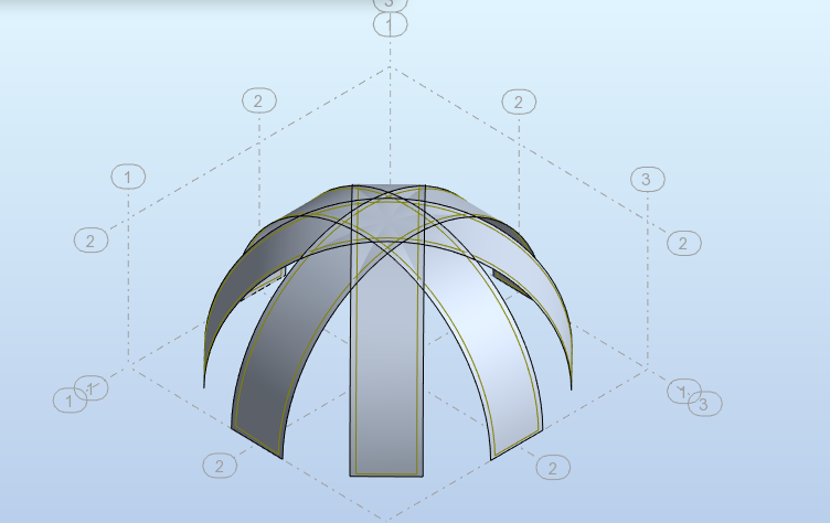

Hi guys,
So I'm trying to model a complex shape as in the picture below, I've tried different ways to create this shape but I alawys fail.
So I'm asking if there is anyway that I can remove the intersections of the panels shown in the picture to get the reqired shape?
and if there are any other ideas to create this model, please suggest it 🙂
models are attached,
thanks 😄

Do you want a spheric dome or the curve d panel strips are to be cylindrical?

Hi @Rafacascudo,
what I want is similar to a dome but with some cuttings (I don't have a word for this shape Smiley Frustrated ) , but the picture below shows the shape I want.

Hi @Anonymous
I'm attaching the meshed model however you need to have RSA 2019 to open it.

Hi @Anonymous
Conversion to ACIS and Union of all panels however with some additional action that you will not be able to do in the current commercial version of RSA. Smiley Sad
I'm attaching the rtd file I missed. I hope it will help. Smiley Happy

Hi @Artur.Kosakowski,
I mannaged to do my model, however compared to your results, I've found a difference!
So by any chance if you can check my model and see what I've done wrong ? Smiley Sad
The first picture is your model displacement after changing the supports to fixed, the below it is my model!
and thanks alot @Artur.Kosakowski Smiley Very Happy

Hi @Anonymous
Check the materials (thickness in both models).
In my model when I try to change the thickness it doesn't change Smiley Sad , every thing in the properties tab doesn't change! what is the reason?

Hi @Anonymous
For extruded / revolved / ACIS panels the thickness label is not displayed in the Inspector as it is assigned to its sides.
