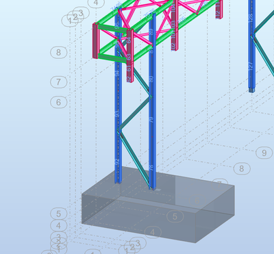

Hi all,
I am designig the following truss:
As you can see, the columns are close to its other, therefore I want to design a combined footing. Then I select the 2 nodes of the columns and enter in the RC design module and I select yes to design one spread footing with two columns. I do not want piers, so I put the initial numbers like this:
When I calculate the example I get "Problems with the reinforcement patterns" So I am doing something wrong. Also I do not want to have any pier, just column bolted to the footing. But I have not much of a idea of the steps to get that.
See attachment.

Hi @mikelt6CWRJ
Open Analysis > Reinforcement pattern >Pier tab
Switch off all patterns for pier
OK
then calculate reinforcement again
