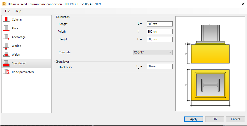

I recently started using Robot Connections capabilities and found it very useful. In addition I would like to know if I could set the distance of my anchors/base plate on each side of the concrete base. Could this be added to the next version maybe? Thank you

Hello cv10037,
I think this is already possible, see screens:
Input foundation:
code parameters, activated CEB analysis for additional concrete checks, like cone and edge failure :
