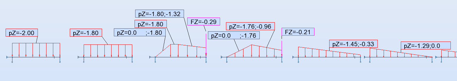

I ran into some calculation errors using cladding option in RSA, so i created test to see if RSA generates line load to member corectly.
I made 2x2m rectangles each rotated by 10 degrees to see if the position angle makes difference and I concluded that rectangles rotated 20 and 30 degrees were not correct.
I am attaching RSA file for more information.

I still got no explanation why loads are generating this way, can someone please explain?
