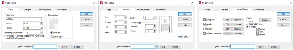

In the process of making the report of a study through the API, I've had difficulties to find how to modify the title page and headers from the API. Do someone know if it is possible and if possible, how ?

try RobotPageSetup properties and methods.
some additional explanations.
Sub SetPageSetup()
  With New RobotApplication
    If Not (.Visible = -1 And .Project.IsActive = -1) Then Exit Sub
    With .Project.PrintEngine.PageSetup
      .PaperSize = 9 ' << 9 = A4, 8 = A3
      .PageOrientation = I_PSO_PORTRAIT
      .MarginTop = 30
      .MarginBottom = 25
      .MarginLeft = 16
      .MarginRight = 19
      .Gutter = 2
      With .TitlePage: .Active = True: .Frame = I_PSFT_NONE: End With
      With .Header:    .Active = True: .Frame = I_PSFT_FRAME: End With
      With .Footer:    .Active = True: .Frame = I_PSFT_SEPARATION_LINE: End With
      With .Variables
        .SetValue "PROJECT_NAME", "MyProject"
        .SetPredefinedValue IRobotVariablePredefinedId.I_VPI_REPORT_PAGE_NUMBER, 1
      End With
      isSaved = .Save
    End With
  End With
End Sub

Don't forget to save after doing some changes 😉  Ex changing header:
robApp.Project.PrintEngine.PageSetup.header.LoadFromFile ("C:\lixo\header.rtf")
robApp.Project.PrintEngine.PageSetup.Save

Thanks a lot, it works fine now !
