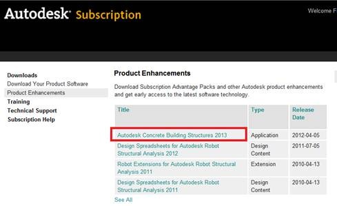

I did not find new version of CBS after installation RSA 2013.
We must say goodbye to this good program?

Download it from Subs

Maybe CBS not available for all countries on Subscription.

If possible try to edit your subsciption parameters and set country as France or Poland.
