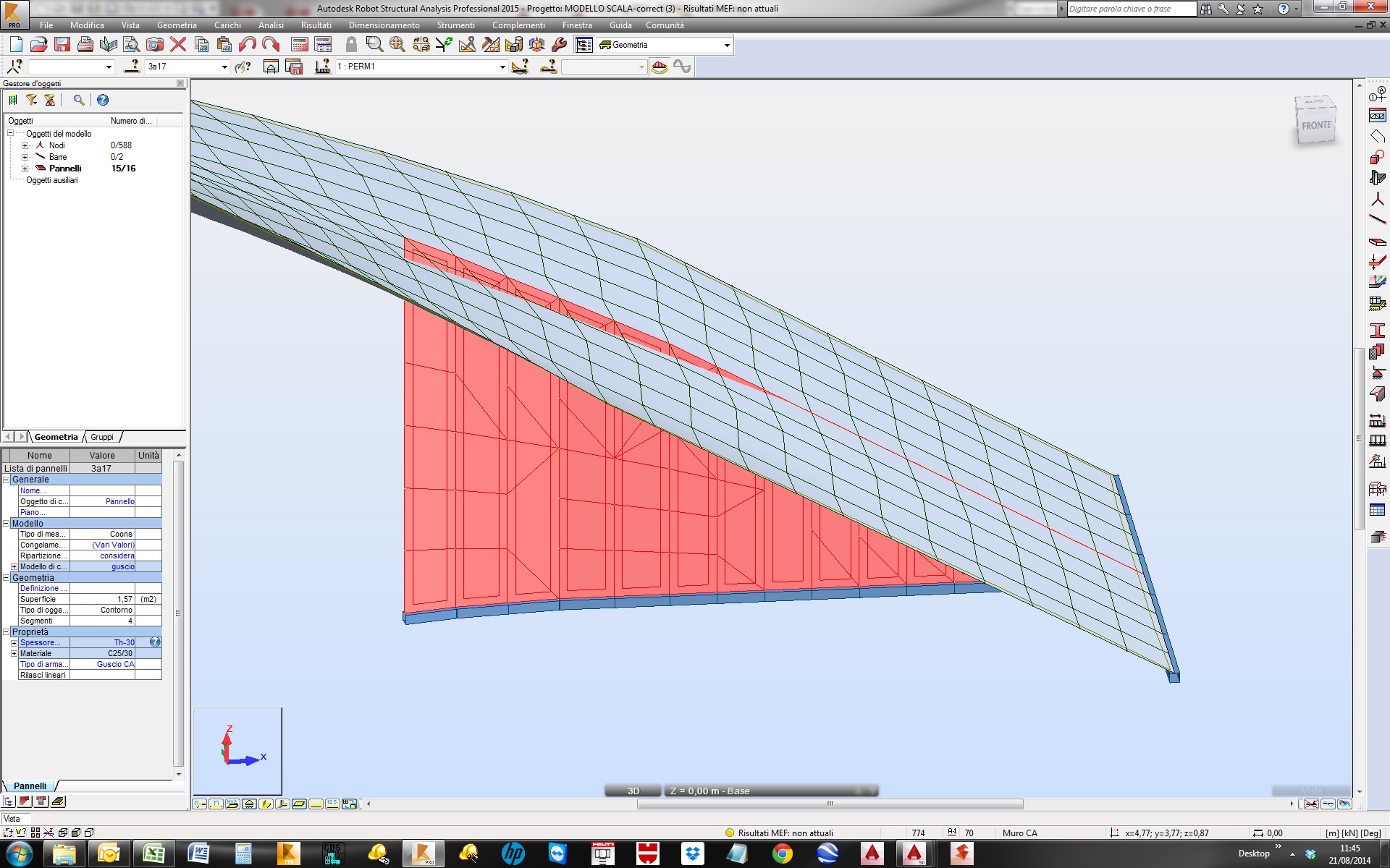

Hi everyone, I have a lot of problem to mesh this complex slab and I can't understand why.
See the attached models, pleas help me.

some of your panels weren't flat (tolerance :0.01) using flatness API -> using geometry (API) converter to divide into triangles.
mesh is not that cool (big smoothing) but at least it calculates -> play with the delaunay parameters (as is is triangles and "turning" coons don't provide proper mesh)

Thanks a lot for your commitment and your suggestion. I already use geometry converter and already use triangular FE. When the meshing procedure arrive to 77% in my pc, Robot freeze. Using Delunay parametrs, as you suggest, everything goes ok!!!

So, I have increased the thickness of the slab from 25 to 30 cm, now I need to do a stiffner beam in the middle of the ramp, but when I try to create this stiffner the complex slab it going crazy.

Could you be more detailed and explain what you man by slab going crazy? Smiley Happy
Perhaps you could attach the current version of your model and couple of screen captures that illustrate the issue that you would like to solve?

The following picture show what I mean for "going crazy":
Well, I used the midline points of the complex shell to create the underwall as a stiffener, but the shape of the upper complex slab it show an out of plane shape, I can't understand what really happened.

Artur.Kosakowski
Autodesk Support
Autodesk Support
Like that?

StefanoPasquini6790
Absolutely perfect, this is the right model.....
