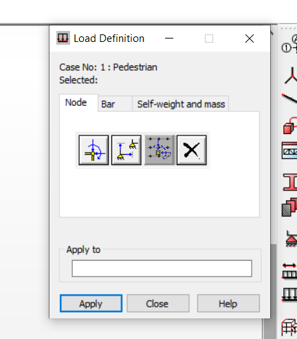

I seem to be unable to apply a surface load to my 3D Truss model. I have made a cladding layer so I thought I should be able to?

Hi @charles.hemmingclark
Planar loads are not available for 3d Truss structure type. Change structure type to Frame 3D
