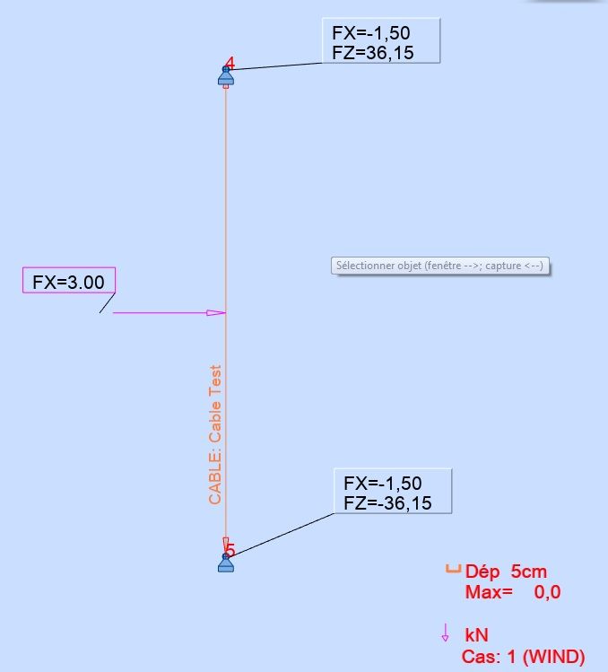

Hi Friends,
I'm very new to Robot and trying to understand how to use cables. The results I was getting didn't seem quite right. So, I modelled 2 nodes vertically aligned, pinned supports, connected with a cable. I applied a point load at midspan. The horizontal reaction was zero, good. The vertical reaction was the same (half the applied load) at both supports. I would expect the reaction at the top to equal the total applied load and the reaction at the bottom to be zero. The results mean that the cable must be transferring half of the applied load in compression.
What I really want to model is cables at other angles, 15, 30, 60 degrees etc., but when doing that the results seemed odd. The above was my way of testing, I showed what I suspected.
I would really appreciate any help with this one. As it is, I have no value for this part of the program.
Curly.

Simau
@curly.hart
In this test with a wind load at the center, there is no compression on both supports
Test model  attached

Simau
@curly.hart @Rafacascudo
It seems that for SW, there is compression on both support (vertical and horizontal postion).
Initial length was taken as distance between support (no elongation)
M. Agayr
Message 5 of 13
Simau
No need to input an initial force or an elongation.
In this test all works ok
M. Agayr
