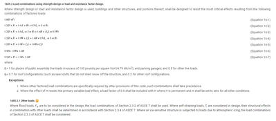

I am trying to build custom load combination to match all of the load types defined in ASCE 7-10 or ASCE 7-16. To start I am trying a few simple modifications to try and learn what is being done in the back end.
I have found that for some reason the automatic combinations keep using the service load factor for the ULS load combinations in some instances. see ULS/2 in the attached screenshot:

I would like to replicate these load types and combinations:

This formula (20) was designed mostly for EC code SLS frequent combinations.  It is not documented well but it indeed use gamma_s factor.
You can use instead formula (45)  and psi_0,3 factor for SLS combinations.
Actually why do you want to define 0,6 factor for wind in LRFD SLS combinations?

DonBAE
@okapawal we want define SLS as 0.6 because the ASCE 7 wind definition is an ultimate condition and in lieu of defining a separate 10yr MRI wind load for service checks it is fairly standard practice in the States to apply the 0.6 ASD factor when checking deflections.
Thank you for the information and suggestion to use formula 45.
Would it at all be possible for the ASCE 7 combinations to be updated to include the full combination and load definitions outlined in message 2 in a future Robot update or release? We run into needing to account for earth, ice and fluid loadings fairly frequently.

Actually it would be better to define the load combinations per the IBC as that is typically the governing code.
CHAPTER 16 STRUCTURAL DESIGN, 2018 International Building Code (IBC) | ICC Digital Codes (iccsafe.or...

okapawal
Hi @DonBAE
 I will update ASCE combination rules and share with you for checking.

DonBAE
They are or(exclusive), the snow loading computations contain provisions for including rain-on-snow surcharge which is to be included in the snow (S) loading for combinations.
