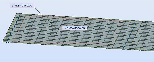

Well, i've used your examples to export my loads by macro.
However, in my case, Robot doesn't recognize these loads.
Indeed, for example, here are forces generated automatically when I create my planar load on Robot load table.
And here are the same forces generated automatically when I import them from Excel thantks to macro. The caracteristics of the two planar loads on the load table are the same...
Do you know what the problem is due to?

What is the problem? Scale of load symbol?
Check sum of reactions for these cases.
