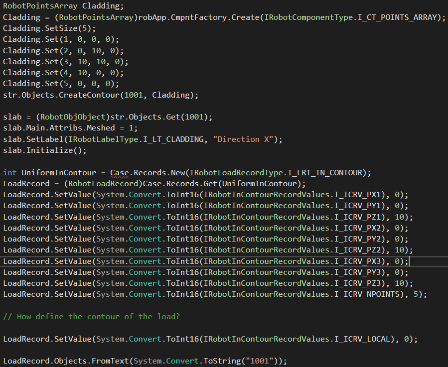

Hello
I would like to create a load in C #.
I do not understand how to create the contour of this one?
I'm deadlocked ...
JM Stevenant
My code:
Message 13 of 28
Rafal.Gaweda
Autodesk Support
Autodesk Support
Hi @Anonymous
Just edit my macro to see what is missing.
LoadRecord.SetContourPoint .........
Rafal Gaweda

Thank you for your prompt reply.
However, I have already tried and it's bug:
Severity Code Description Project File Line Deletion Status
Error CS1061 'RobotLoadRecord' does not contain a definition for 'SetContourPoint' and
no 'SetContourPoint' extension method that accepts a first argument of type 'RobotLoadRecord'
was found (using directive or assembly reference) missing?)
Thank you for your help.
Message 15 of 28
Rafal.Gaweda
Autodesk Support
Autodesk Support
Hi @Anonymous
My guess it that your LoadRecord is of not correct type.
You need something like this:
RobotLoadRecordInContour LoadRecord= (RobotLoadRecordInContour)case.Records.Get(UniformInCountour);
Rafal Gaweda
Message 16 of 28
Yes perfect that's work now,
Thanks you!
