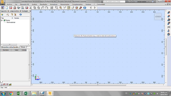

1.pngHello friend, a favor, I want to make a macro
in visual basic for applications to design a
foundation with the structural robot but I can not find the right
codes, please send me the codes for this sequence
Through this code "Dim RobApp As RobotApplication
Set RobApp = New RobotApplication
If Not RobApp.Visible = True Then
 Set RobApp = Nothing
 MsgBox "abrir robot"
 Exit Sub
End If
RobApp.Project.New I_PT_FOUNDATION" I can get to this image:
And I would like to come to this:
And finally the codes can be sent to change some parameters like admissible capacity, dimensions of
the founding, etc. thank you very much
for your support

Example code:
Dim RC As RobotProjectComponent
Set RC = Robapp.Project.ComponentMngr.Create(I_PCT_FOOT, "f", "1")
Dim IRCF  As IRConcrFooting
Set IRCF = RC.Data
IRCF.Geometry.SetDim I_CFDT_FOOT_DIM_A, 5
Rafal Gaweda
Thank you very much my friend, it worked perfectly. You could make a code to modify the dimensions of the foundation, as well as some properties of the soil with permissible capacity and specific weight. Many thanks and sorry for the inconvenience, my friend.
