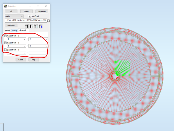

Is it possible to directly select nodes with the geometry filters shown in the image attached via API? At the moment I'm selecting all the nodes and filtering them in the code but unfortunately when the model has too many nodes it becomes extremely slow.

you can select from nodes of panels and filter by coordinates on this more restricted list.
After that, yes, it is possible to do it by API. Here is a commonly used generic method
Sub SelectNodesByCoordinatesRanges()
  Dim RobApp As RobotApplication: Set RobApp = New RobotApplication
  Dim NodCol As IRobotCollection, NodSel As RobotSelection
  With RobApp.Project.Structure
    Set NodCol = .Nodes.GetAll
    Set NodSel = .Selections.Get(I_OT_NODE)
  End With
  Dim bounds As Variant: bounds = [Limits].Value2
  XMin = bounds(1, 1): Xmax = bounds(1, 2)
  YMin = bounds(2, 1): Ymax = bounds(2, 2)
  ZMin = bounds(3, 1): Zmax = bounds(3, 2)
  For i = 1 To NodCol.Count
    With NodCol.Get(i)
      If WithIn(.X, XMin, Xmax) And WithIn(.Y, YMin, Ymax) And WithIn(.Z, ZMin, Zmax) Then Txt = Txt & " " & .Number
    End With
  Next
  NodSel.FromText Txt
  Set RobApp = Nothing
End Sub
Function WithIn(V, VMin, VMax) As Boolean
  WithIn = V > VMin And V < VMax
End Function
