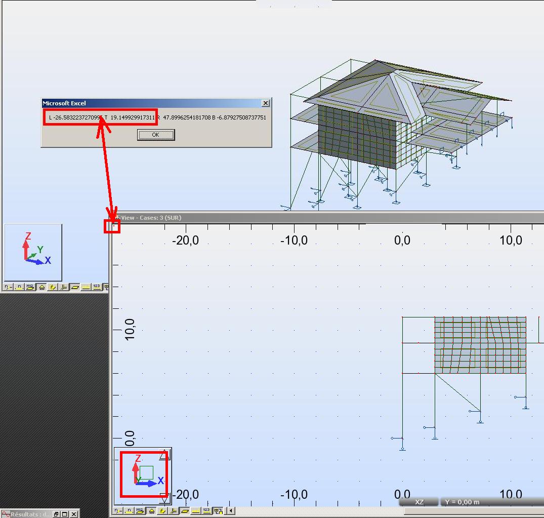

Hi I would like to make a zoom of my picture because I can't anything on my screen capture. I wrote this command but it's not good written. Would you mind correct it ?
mavueRobot.GetZoom(2, 2, 2, 2) = 1
I would like make a zoom of 150%.
Message 23 of 147
Rafal.Gaweda
Autodesk Support
Autodesk Support
It is not that easy because zoom depends on real coordinates and viewport size \ aspect ratio.
Small 2d example below. Left top corner is important and vieport aspect ratio
3d example  (left top corner is related to left top corner on ZX plain view) ; additionally you should define rotation point and rotation angle
Rafal Gaweda

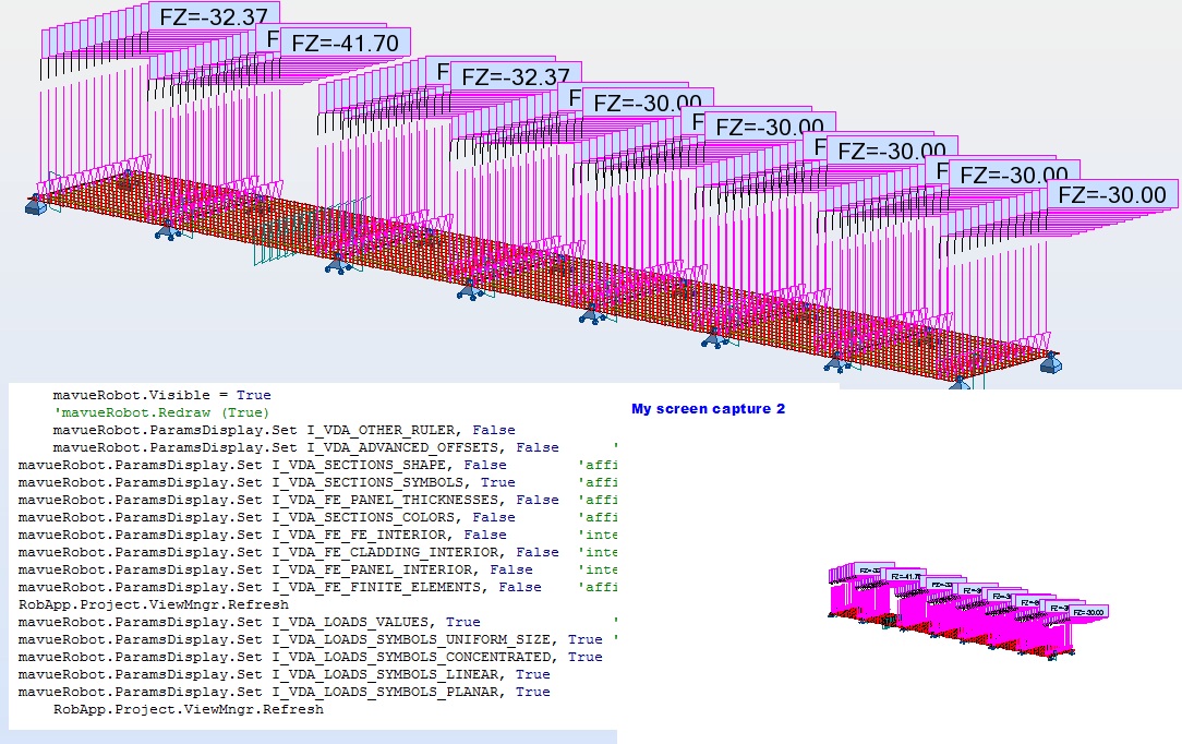

I have got a problem with the display. The symbol of loads doesn't appear.
The refresh is not done. Have you got an idea ?
mavueRobot.ParamsDisplay.Set I_VDA_ADVANCED_OFFSETS, False      'afficher exentrements
mavueRobot.ParamsDisplay.Set I_VDA_SECTIONS_SHAPE, False        'afficher croquis barres
mavueRobot.ParamsDisplay.Set I_VDA_SECTIONS_SYMBOLS, True       'afficher symboles barres
mavueRobot.ParamsDisplay.Set I_VDA_FE_PANEL_THICKNESSES, False  'afficher epaisseur panneaux
mavueRobot.ParamsDisplay.Set I_VDA_SECTIONS_COLORS, False       'afficher profilés en couleur
mavueRobot.ParamsDisplay.Set I_VDA_FE_FE_INTERIOR, False        'interieur element finis
mavueRobot.ParamsDisplay.Set I_VDA_FE_CLADDING_INTERIOR, False  'interieur bardages
mavueRobot.ParamsDisplay.Set I_VDA_FE_PANEL_INTERIOR, False     'interieur panneaux
mavueRobot.ParamsDisplay.Set I_VDA_FE_FINITE_ELEMENTS, False    'afficher elements finis
mavueRobot.ParamsDisplay.Set I_VDA_LOADS_VALUES, True               'valeurs charges
mavueRobot.ParamsDisplay.Set I_VDA_LOADS_SYMBOLS_UNIFORM_SIZE, True '
mavueRobot.ParamsDisplay.Set 68, True                               'symbole charges ponctuelles
mavueRobot.ParamsDisplay.Set 69, True                               'symbole charges lineaires
mavueRobot.ParamsDisplay.Set 70, True                               'symbole charges surfaciques
For i = 1 To 3
mavueRobot.Selection.Get(I_OT_CASE).FromText (i) ' selecting case
mavueRobot.Redraw (0)
robapp.Project.ViewMngr.Refresh
ecran_capture = "charges" & i
Call screen_capture
Next i
 image result
Message 38 of 147
Rafal.Gaweda
Autodesk Support
Autodesk Support
I have got model from you once. There are no loads in case 1 and 3 so there is nothing to be displayed
Case 2 works fine.
