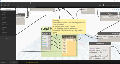

Hi all,
I created a code that creates a ‘load case’(works), and after the creation of the loadcase i want to add a load tot he bar in that particular loadcase. But this gives errors(see picture 1). And after adding the load tot he bar i want to calculate the structure, also with a python script. But the problem with this script is that it’s executed before the structure is drawn in robot.
I have 2 questions about these problems:
  • What/where is something wrong in the code for adding the load tot the bar?
  • How can i solve the problem that calculation will start after it’s drawn in robot.
Complete setup:
picture 1:
Error inside robot
Code for adding load to bars

1234eddie
I solved this by myself.
just use python code to create the structure.
