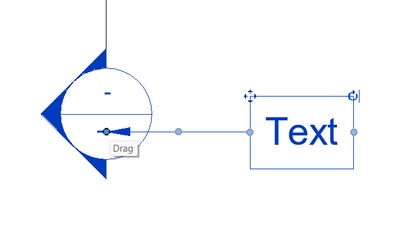

I am working in a plan view.  A standard section cut has been placed on the wall.  I place a text note second and need to create a text leader that points to the wall where the section is cut.  When the leader that is initially created lands over the section cut, even though the text is highlighted and the grips on the leader are shown over the section cut.  When I try to select one of the grips over the section cut, Revit will automatically pick the section cut even though the grips on the text leader are already highlighted and I am over the grip to select the text leader grip.  Why does Revit ignore the previously highlighted grip to select the section cut when I try to choose the highlighted grip?  It happens with other grips as well, but the text leader grips occur most often.  I would like to turn that "feature" off so I can work with the grips without having to press tab to select the grip even though the text and leader are already selected.  It is probably the most stupid "feature" I have run into in Revit.  I hope that description helps.  I have also included a picture to help you understand.  In the first image, the text is selected and the leader grips are highlighted, in the second image I hovered over the end grip of the leader and it is possible to see Revit thinks I want to go to the section instead of the grip I am wanting to select as it was highlighted first.

I can only assume that it sees the Text as a priority over a leader as the Text relates to a function whereby you can "Display the View defined by this section" by double-clicking?
Even Pinning the Section and Turning Off Select Pinned Elements this can still be selected which reinforces you point about it always being selectable.
Setting up a similar scenario
In my version on 2025 if I hover and select the Text and Leader and then Hover over the End Node it goes the darker Pre-Select colour and the word "Drag" appears knowing what action it will apply next and then I an move without issue which again reinforces the above.
The quickest solution is as you mention to use Tab to Cycle -Select the End Node or alternatively use the Temporary View Settings to Hide the Section but again takes additonal steps which you are trying to avoid
