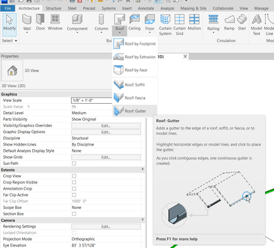

Would it not be easier to use Slab Edges, as these can use Profiles and add Generic Model or In-Place Models for capping ends?
Or either use a Roof then Gutter and Soffits, again you can use profiles which can be adjusted into place
