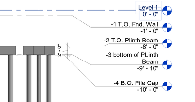

I have created a structural Foundation at -10' (B.O. Pile CAP) Level I have created another level at -9' 10" (Bottom Of Plinth) Level when I switch from B.O. Pile CAP Floor plan to Bottom Of Plinth Floor plan I couldn't find these foundations in B.O. Pile CAP Floor plan. I tried adjusting the view rang and checked visual graphics every thing looks fine. cam someone helps me where did I go wrong.
Elevations
B.O. Pile CAP Floor plan where foundations are visible
Bottom Of Plinth Floor plan where foundations are not visible

Hi @pvamsikrishna736
In the properties bar, modify the phase.
Jamhmer Oc
pvamsikrishna736
Thank you
