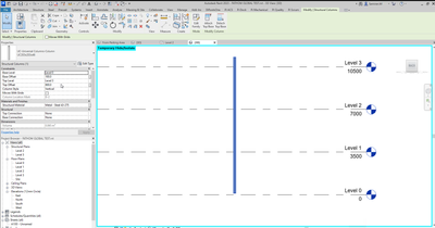

Hi All,
I'm a beginner to Revit and apologies if this has been answered elsewhere already.
I'm attempting to recreate an AUTOCAD drawing i've produced in Revit.
I've imported the CAD drawing into Revit and now inserting structural columns.
I'm unable to edit the column height/base level/ base offset etc.  Said columns are not visible on the floor plans, but visible on the 3d view.
Please advise.
I've attached the following file to the post: FATHOM GLOBAL TEST
Many thanks in advance.
Dan

Have you placed any levels?
Message 10 of 21
alan.johnson7YLND
You might need to add more levels, so that you can change the base and top level of the column or wall,
but even at the point you are at you should be able to edit the base and top offset.
When you start your project add the number of levels required (in an elevation), and then add your grids.
Then you can add columns and walls etc...
Message 11 of 21
Daniel.LiSUV4E
Hi Alan,
Thank you again for your reply and comments.
I've added in additional levels.
Revit has suddenly allowed me to adjust the column height. Extract attached.
I'm not sure what i've done (or not) differently but it appears to have self resolved!
Many thanks for your assistance and patience.
Kind regards,
Dan
Message 12 of 21
ChandanSutradhar
This was already answered, However, I am trying to give you some additional light.
I have verified the column height, and it works very well; you have already added Level 0 to Level 3. You can also be able to change the base or top offset.
Please see the snap, I think you should check the help of the option if you don't know how to place and modify properties for Revit for any items such as column or beam, footing, etc.
See the reference link might be helpful, and the video is ready for your work
https://help.autodesk.com/view/RVT/2023/ENU/?guid=GUID-22967061-29AB-4A26-9390-88C76D441B9B
