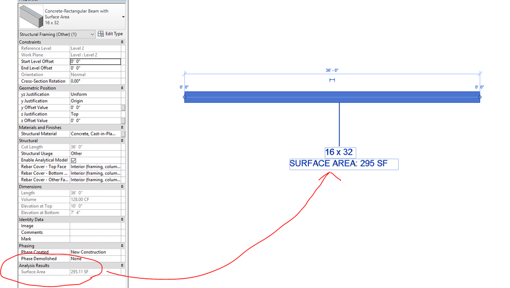

If you only need to report the Surface Area in the tag then the only shared parameter you need is Surface Area, not the dimensions of the beam, and it can be done in any version, not just 2017.
- Create "Surface Area" shared parameter, add it to the Beam family, add the formula (in the example I calculate the total for all sides but it is up to you)
- Add the same shared parameter in a label of the Tag family, no formula needed
- Load both in project and done

I said in the post that I did for all sides as an example. The method doesn't change.
