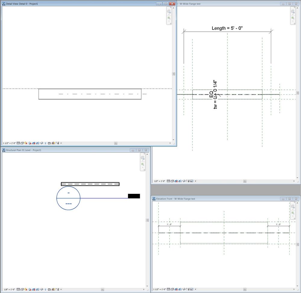

j-kirkpatrick
@Anonymous I don't think there is a way to have a uniform centerline look since it's the beam is line based ish. I'm having issues with the line not wanting to agree with end extensions for both sides. I tried making it be only from the half way point to see if it'd start from the center on the detail. and it doesn't...
I have mine set to Projection, Regular Center line style, as well I drew 2 on each face of the beam. when they were exact to the center they wouldn't appear since they were "inside" the beam. needing 2 this way they show on either side of the cut.
Currently I have them going full length and 1'-0" extended past the beam. Yet in the cut in the top left view the CL only extends 6"... all my start/end extensions are set to 0'-0". When dragging the end extension it doesn't drag the CL, but if you drag the structural framing component end, the CL will follow along.Capture.JPG
