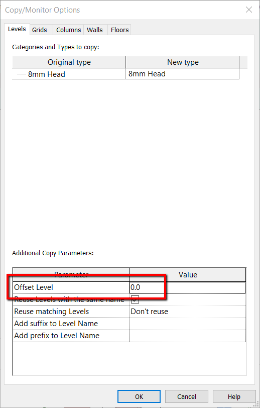

From my experience, levels in structural models always differ from other disciplines' levels. For the Arch and MEP models, levels are usually set at the FFL while structural levels are set at the top of slab or top of steel, depending on the structural design and type of materials (Steel\concrete).  An experienced Revit user can strategize how the levels to be used in the model(s) and how to coordinate them with the other consultants. I would make a little document on this setup, or include it in the BXP of the project.
When copy\monitoring levels (and that depends on who OWNS the levels in the project) when Arch and Str levels do not match, there is an offset parameter you can use in this case.
