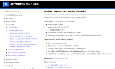

You stated you have an ACC account?
Depends on if you have access to Autodesk Cloud or Docs as part of your Student License offering - check using your Autodesk Account https://manage.autodesk.com/
Help | How Do I Access Cloud Models for Revit? | Autodesk
