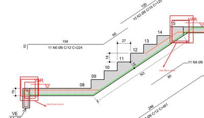

Hi, is it possible to remove the line between the stair and  the beam/floor by attaching the stair and the beam/floor? i couldn't do it
i even tried to do the union on the floor plan but i can only do the union of other structure elements, but the stair i cant.

Just use Linework to hide unwanted lines.
it's in modify tab.

Simplest option is as previously mentioned above by @suskumar
With Concrete elements if the Material is exactly the same this will automatically remove the boundary in most case!
Also you could review the Modify > Join Tool and review the options available and orders etc.

Thanks, it worked well!
