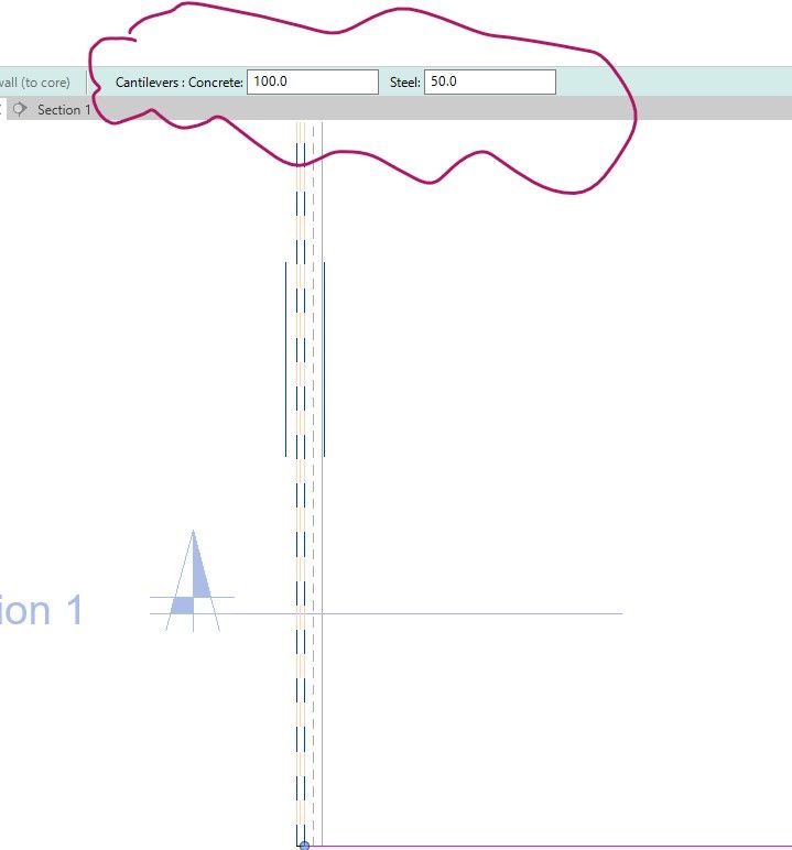

I have created metal deck floor.
How to adjust steel/metal decking so that shear connector can be place at the center of the beam?
see image below
1,085 Views
EdwinG
Edit your floor (Edit Boundary) select te floorline to adjust then the cantilever options shows on top of the screen.
in your case the cantilever (steel) value is negative.
walidinJKACC
thank you @EdwinG I can do what your suggestion.
Now, the problem is that the slab boundary is defined by architect how far the distance. It means that when i move boundary line to adjust shear connection position it is not relevant anymorescreenshot2.png
Do you have other solution, maybe from editing profile of steel/metal decking itself?
