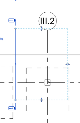

Is there any way to hide section line in sheets view(middle one)?

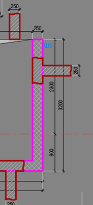

Is there any way to create section views like this: Or I should be creating it manually?
Click on the break symbol and drag the line ends.
Yes. Use a combination of a detail view and detail components.
