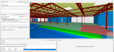

When exporting to IFC, some of my information of some geometry is correct, but other geometry with the same export settings aren't.
See this example:
Selecting a beam in Solibri software from an exported revit IFC shows me this:
I can perfectly see my Classification settings, the reference code and the description.
But selecting and other beam of the same category shows me this:
Steel columns also wrong:
Floors are all ok:
I don't get the logic behind this. If it were all wrong I would suggest it's a configuration error, but some data goes out perfectly so I have no idea what's wrong.
The revit settings are always the same:
Any tips guys?

I think you have only one problem Column and other beams do not show the classification name. I would suggest just reassigning the column and other beam classification/assembly codes and checking the export once again. Let me know your thoughts and further input to Assist you.
Thank You,
Chandan
semi
Thanks for your reply. What should I reassign my column to? These are the settings of the columns:
