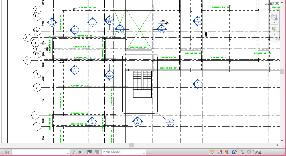

1. How do I tie floor sections to each floor plan, such that each floor section number or name starts with No. 1 on both Layout and Section Drawing Sheet?
FIG. 1: FIRST FLOOR PLAN
FIG. 2: FIRST FLOOR PLAN - SECTIONS

I'm assuming you want it to read something like 1.1, 1.2 and 1.3 or 1-1 and 1-2 etc, you'll have to manually renumber each section.  You can edit the numbering in the Properties for each section or detail, under Detail Number.
Thank you.
I have already resulted to editing the section name to suit my intention.
