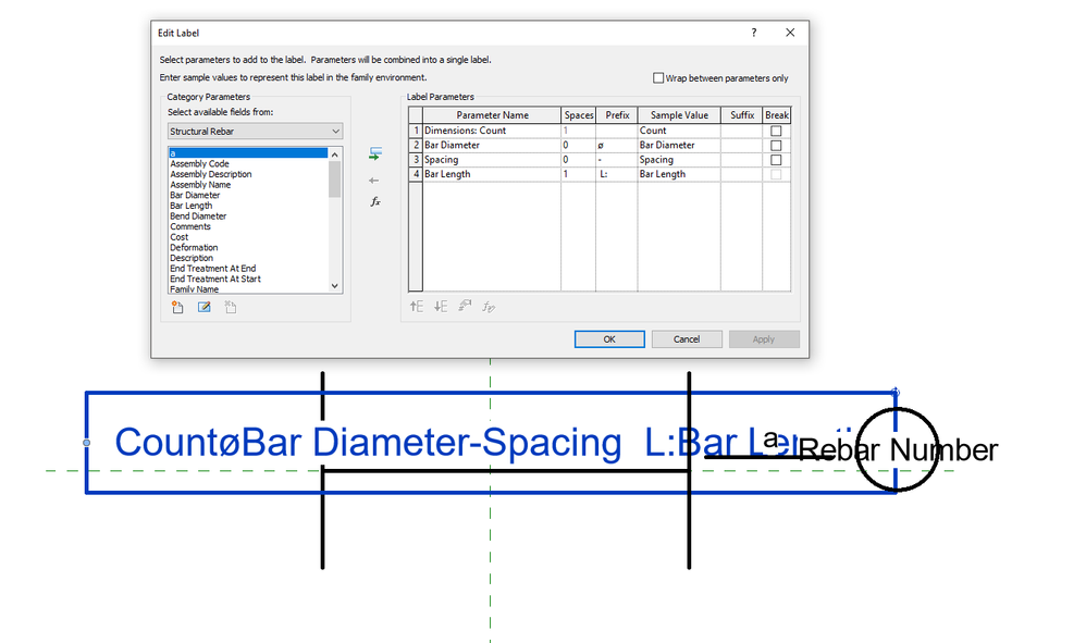

FDC, how do you handle tags and MRAs for variable rebar sets if you have to specify the number of rebars?? It seems that I have to use "quantity by rebar set" in labels to get the right quantity, as the "quantity" field is giving only 1...
Message 20 of 22
-FDC-
I use count
