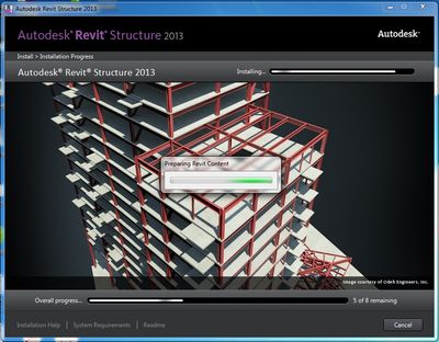

I am trying to install Revit Structure 2013 on one of our users' machines and am running into some problems:
When running the installation, it gets to ~80% complete when a small progress bar labeled “Preparing Revit Content” pops up.  This dialog hangs stays put for long time ,
I have attached screenshots of the errors
Can you please help provide any suggestions for how I can correct this to ensure Revit 2013 is installer properly?

Can you please disable the anti-virus software and install the same? If you can uninstall the anti-virus during the installation of Revit that will be even good, as sometimes anti-virus is automatically starts even though it is disable.

If not, I think that problem is indeed in the Revit content. I too had a lot of trouble installing Autodesk software.
Each time when I was not be able to successfully install Revit, I disabled every family content and it worked every time.
So, try to install Revit without Revit families packages.
I think Autodesk should allow users to download content directly. Installation is very fragile and it takes a lot of time to get stuck on something that's, well, just files.
