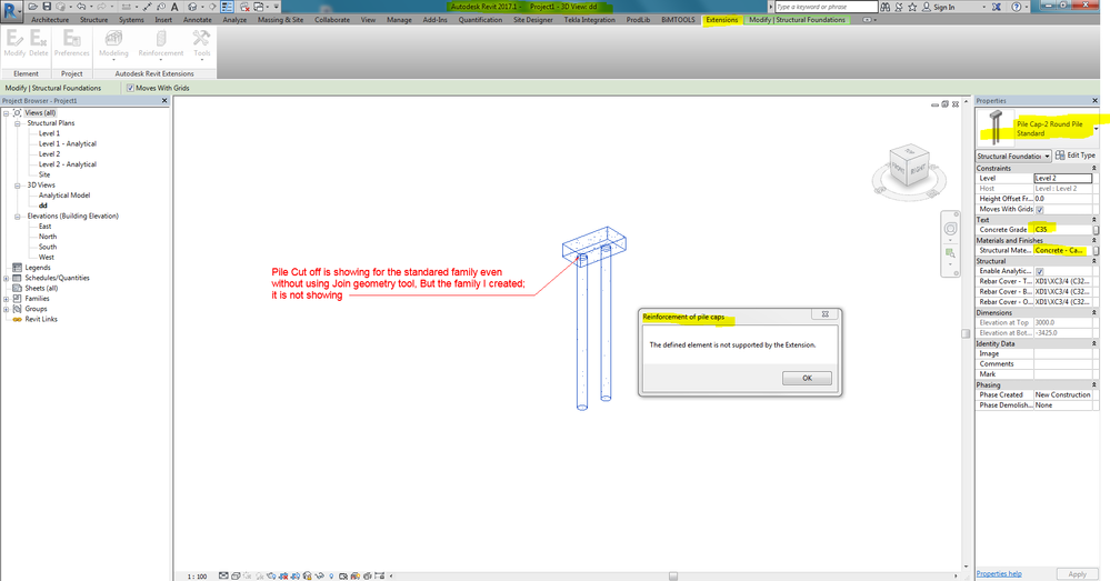

My Pile Cut off parameter (pile embedment length inside the Pile Cap ) is working as intended in the family environment but once I uploaded that to Project environment it not working as intend. Could anybody check and suggest any solution ?

Thanks for the reply, The unjoin geometry tool is working as you said. But please check the attached family with this post.This is a standard Pile with Pile cap provided by Revit and the cut off is working as intended even in the project environment without using unjoin geometry tools.. But the problem is it could not identified by the Revit extension for the Pile and pile cap reinforcement purpose. So that I have created the same and it is identifying by the extension but Pile Cut off is not working in the project environment. I change the materiel for model behavior and still no luck.

shefypattambi
Dear Mr.Niels,
 The standard pile family is two types : - Pile Cap-2 Pile (Steel Pile)  and Pile Cap-2 Round Pile ( Concrete Pile). I use the Pile Cap-2 Round Pile (Concrete Pile) with Revit 2017.1 and unfortunately for this standard pile; TAB key is not working to select the pile but it is working in the pile family that I created.
Please have a look at the attached pic

N.Oomen
Hello shefypattambi,
When I look at your family choice it seems different from mine.
I looked what content library I installed and if that could be the difference.
I am using Netherlands Specific content and it seems that we use different families.
I will attach one of those families for you to test.
I think your Pile objects are not shared, and/or might not have te right material in the nested family.
Please have a look at the attached file.

shefypattambi
Dear Niels,
You are absolutely right. The family is given by you is identifying by the extension but the default family given by Autodesk for the UK region it is not identifying. I tried both the "pile Cap" and "Pile" family parameter to shared and change the material also. Still its not working. Could you please upload your Pile cap with 2 concrete pile and pile cap with 3 concrete pile for the Netherlands region further to test?
1) Still what would be the reason; cut off not working for my family ?
     It is working for the Stndared Revit Pile.
