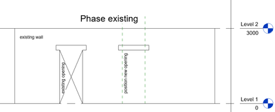

I have a 'wall based void family' loaded into a 'opening family' to control whenever i want to see a lintel (void).
When the 'opening family' is loaded in to the project the Phase is not recognized or set from the 'wall base void family'.
When the 'wall based void family' is directly loaded into the project the Phase is recognized and works as expected.
Add another opening in the family is not an option because it is not controlable with visibility parameters.
Also attached a smal project.
Is it possible to solve this?
Thanks.
361 Views
You cannot set phasing to nested families, only parent families.
