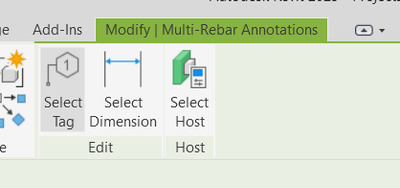

Instead of displaying all dimensions between the rebar set, is it possible to show only the dimensions of the two sides of the rebar first and last like the attached picture. Screenshot 2025-02-09 182558.jpg

Select the Dimensions element of the Tag (Select Tag > Contextual Tab > Dimension)
Scroll down to Other and change Equality Witness Display to Hide

Edit the Linear Dimension Style -->Equality Witness Display to Hide

Thanks a lot
