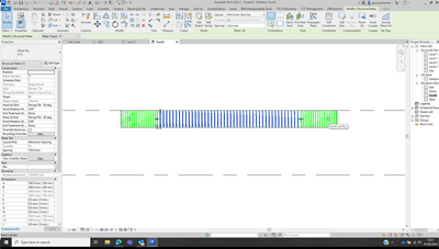

Is it possible to provide multiple spacing on a rebar group, for example, with L/3 spacing along the length of the beam at 100 c/c on either side and 150 c/c in the center third of the beam?

Unfortunately no, not without an addin!
You would need to Copy and edit the spacing, place along full length, stretch to one end first, mirror around center to place at the other end and then copy along into the middle, adjust spacing and untick Reset Last Rebar to prevent overlapping and stretch to suit.
You can however use the Multi-Rebar Tab to group these sets and tag in one process.
