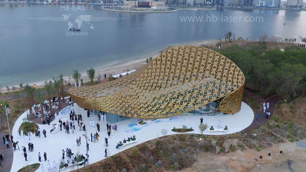

hi everyone
i am trying to create mass object for this attached pis object. but its not working. please guide me how to create this mass in Revit. thank you in advance.

You need to create some mass surfaces following those curves, divide the surfaces and use a generic adaptive pattern family that will automatically adjust to the panels resulting from the split.
There are a lot of tutorials out there. Here are two examples:
https://youtu.be/9lXr-lUbeLk
https://youtu.be/ZsAq7p3-DKk
