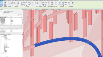

Hi Everyone,
I am stuck in this Column and beam  connections.
Can anyone help me out with it?
I have attached images for the reference,
Thank you in Advance.

Hi @akash.kotadiya
I am assuming you are wanting to put steel connections on?
Steel connections in Revit don't work with curved items - https://knowledge.autodesk.com/support/revit/learn-explore/caas/CloudHelp/cloudhelp/2021/ENU/Revit-S...
You would need to create some dummy beams at the intersections to get the connections tins to work then hide the dummy beams
