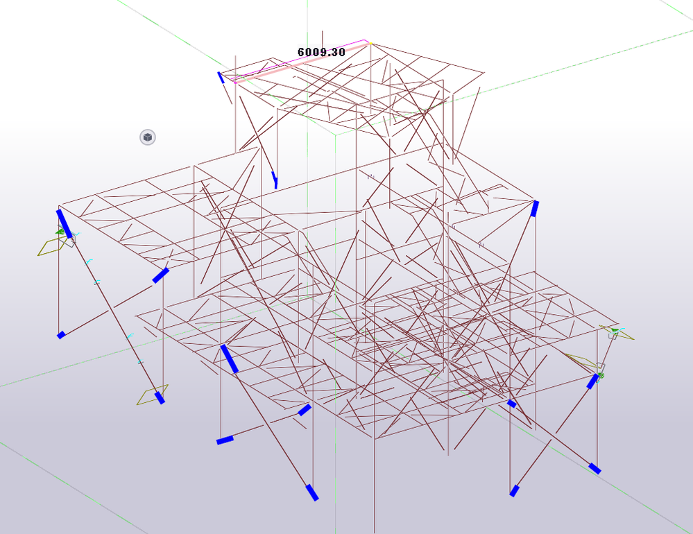

Perhaps not the right place to ask, but any info would be appreciated!
"I'm trying to export a steel model from Tekla with just the steel centrelines and the ends of the lines fully connected. This must be done with each line being under a layer representing its steel member/sectional size. I've been struggling with filters so my plan is to take it from Tekla to Revit via IFC and then exporting the analysis model. ANY ADVICE?"
