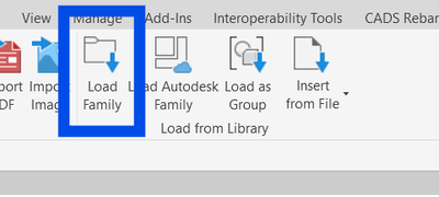

However, I recommend simply importing them from the Library Family Content from the Insert Tab
Then use the relevant  Content
Alternatively use the Load Autodesk Family
You could do this then Save it as a Template for future use
