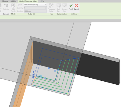

Hello, I have repeated trouble reinfocing this shape. How can I achieve this?
Plan:
Section:
3D:

Hi @daniel_compel
For the corner bars, you can use shape driven rebar (M_17A for example - L shape bar) set to varying
After setting it to vary, you can edit the constraints, select those segment handles and click the inclined faces. Set the constraint to by cover and offset 0.
The ends automatically constrain to the closest face, so the bars are the same length. If you want them to vary in length as well, you can constrain them to a vertical face in your model. It can be in the same host or outside

attached sample file with above example

Yes, that helped a lot. Thank you very much @ovidiu_paunescu . I knew the variable rebar function but I didnt think of using it on this shape.
