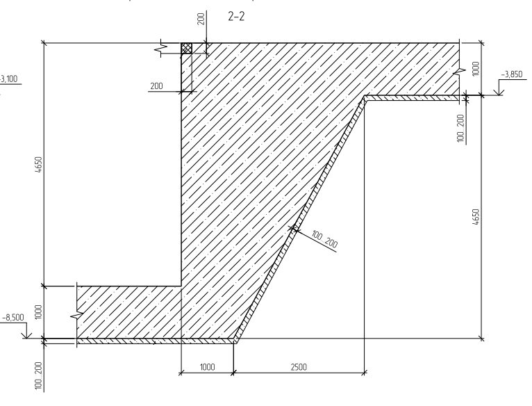

Top is a slab with a slab edge. Bottom is another slab. Join them.
EdwinG
create the 2 slabs
create a Model In-Place , Family Category can be Floors, Generic model or Walls
Create a Sweep
set the material from Model In-Place the same as your slabs.

it's better to use @ToanDN  solution...
if you need it parametric and can use it in many projects make the part as a family.
i don't recommend using model in place if there are other solutions...

EdwinG
I agree; certainly if you need to use it multiple times
Don't be offended but i personly don't like the slab edges that much i have much more control with an Inplace solution.
Ahmed_Muharram
as for my self i prefer to use family as i can use it in other projects and also many projects i worked in limits the use of model in place in the BEP .
but i cannot say model in place is not a solution 🙂
Ahmed Heteba, PMP, bsi, B.Sc, AEE, ACI, ACP
Senior BIM Manager @ EllisDon
You can always change in-place to family in 5 sec 🙂
